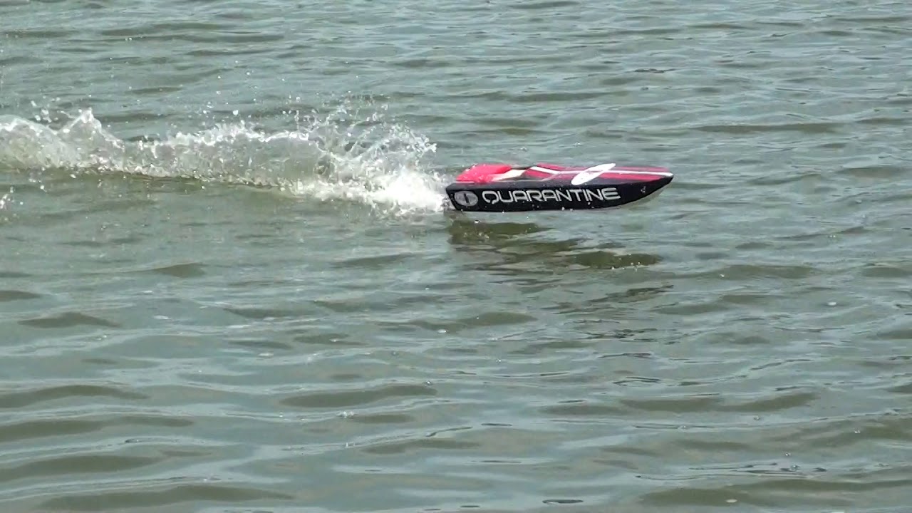

                            Finally got around to running this bad boy... First off, the boat bobs up and down (see video). I am not sure if it is a balance issue or a driveline angle issue (I am inclined for the latter, but maybe both!). For the run, I pushed the battery as far forward as it would go, so it may be a bit heavy in the front.
                            I ran it easy, mostly at around half speed. I did give it a couple of runs at full throttle, but was mostly running at half throttle. At the end, the boat would not turn (it was locked into to a left handed turn). Then, I lost throttle as well (you could hear the motor, but no action from the boat). I figured I had lost my prop, so I waited for the boat to float to shore.
                            Once we recovered, I noticed we did have a prop. The issue (I would find out when I got home) was actually worse; it seems Steven was right to warn against using a 4S. In my first run, I stripped the gears on the drive!
                            Looking deeply back at home at the problem, the issue is that the gear was not meshed properly. So that is something I will have to take care of once I get the new shafts for it, which I need to take care of now (edit: Already ordered from OSE!)... Oh, and the cause of the left turn lock? I forgot to put Loctite on the bottom bolt of the direction system (it has two bolts, top and bottom; bottom one is gone!). Good news is that at least the cat ran like a dream!
                            Here is the video of that first run, so you can give me some advice on how to fix the bouncing issue:
                            What is my issue? Drive angle? Center of gravity too far back? Or too far forward? Or a combination of these?
