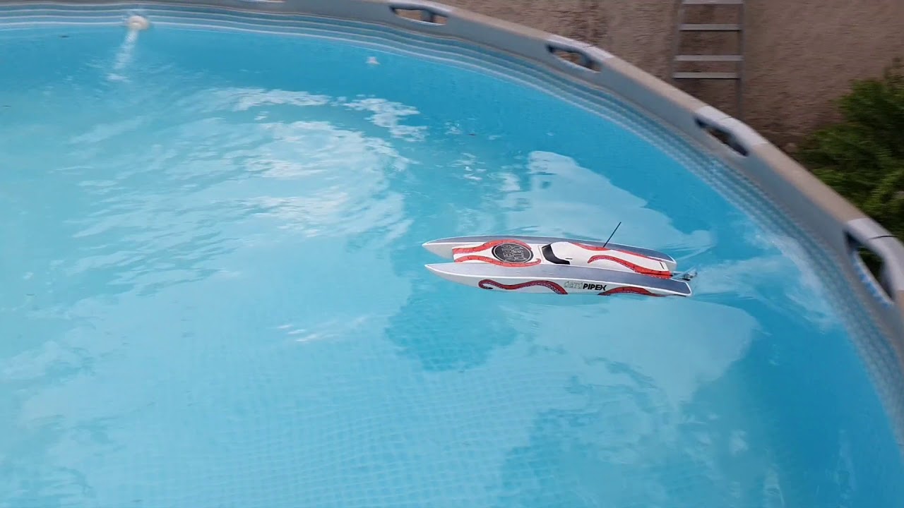

                OK, guys, need your opinion... With all this quarantine lockdown, I cannot go to the lake, so I did the next best thing... Took my almost ready boat to the pool in the backyard (you know, those temporary ones that are about 12 feet round?). I know, I know... bad idea to run an FE in a pool... especially without grease in the flex shaft... But I could not hold myself. So, I had my kid recording. Seems to me, the boat is raising its nose when I accelerate. The are SUPER short runs, and I don't even get to half throttle, yet the boat seems to jump out of the water.
                So, a bit more weight to the front, or too early to tell yet?

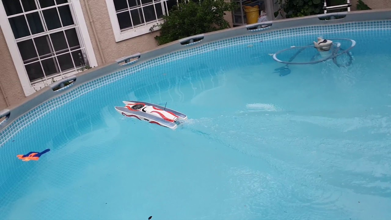

                  Here is the second run:

                          It's too early to tell.
                          Boats almost always raise their noses under acceleration, there are 2 main reasons for this:
                          A boat prop is generally at the bottom of the hull, so the CoG is almost always higher than the thrustline, causing a nose up under acceleration.
                          The front of a boat generally has a much higher angle of attack than the rear so provides much more lift when the speed is low enough for it to be in contact with the water, this causes a nose up at low speeds. (At high speed on flat water the hull only touches the water from the CoG backwards, so the bow angle doesn't matter (this also explains why you go faster with a more rearward CoG, you have a smaller wetted area))
                          When accelerating "out of the hole" (from stationary) you generally have both effects working to raise the nose.
                          Edit. I say generally because there are some unorthodox boat designs out there that don't have these effects, and if I gave absolutes someone would say "my S.W.A.T.H. hull doesn't have the second effect", or "my submarine doesn't have either effect", but all high speed planing boats do have both effects, including all planing FE model boats.
