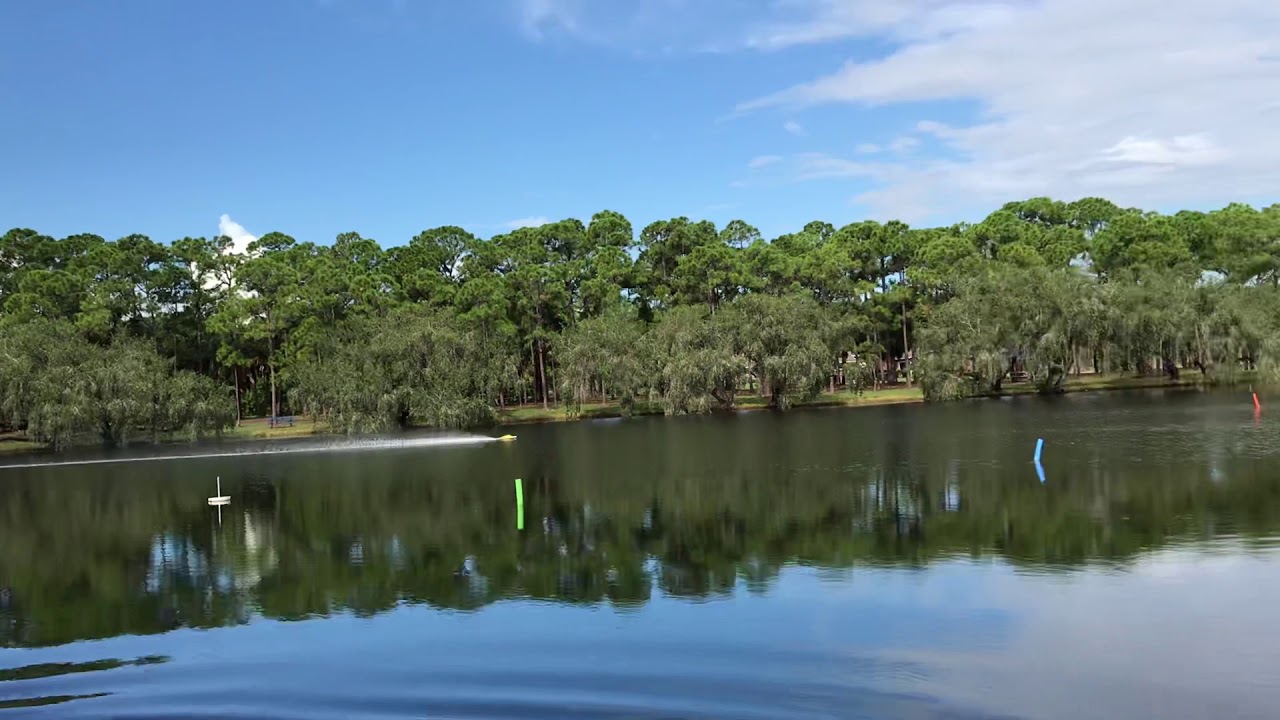

          Got some video for a few laps today.

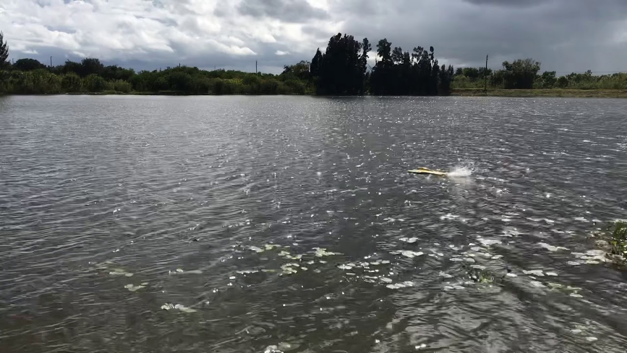

                        Got someone to video today. Still with m452 but with 6000mah 65/130c graphenes. Put m455 on and I think I pry should flat spot shaft where drive dog goes, something was slipping after I changed prop. Then the rain came.
