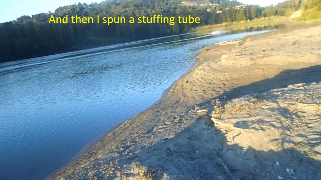

              Yup, 12s and 1020kv’s on mine:

                That's cool!!! And what a great place to run!

                  So the stuff tube broke away from it's attachment points? Did the flex survive?
                    Yes it did. I have since found the vibration that caused it. I still need to sand and paint the ride surface and she is good to go again.
                    Yeah that lake is a beautiful spot, private behind a gate, but the geese got in there and brought a weed and now at this time of year it’s tuff running.
