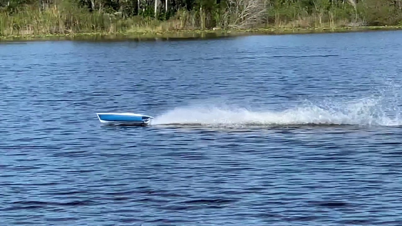

                    #39
                    Here is video of the owner test driving it after completion. No warp speed runs since he is still getting used to it.
                    • properchopper
                      rcgoatbuild@snotmail.com
                      • 7708
                      #40
                      Looks great - (obviously a little less rudder travel will prevent the spinouts) Nice Job ! [at the end of the video you can hear chuckling - Exactly what Jersey Skiffs do for you - Pure Fun ]

                        Thanks, programable radio is on his x-mas list. He and his family are very happy with the model..
