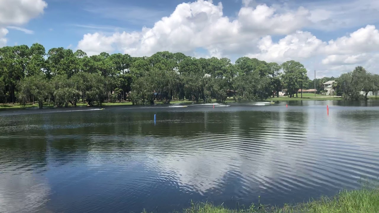

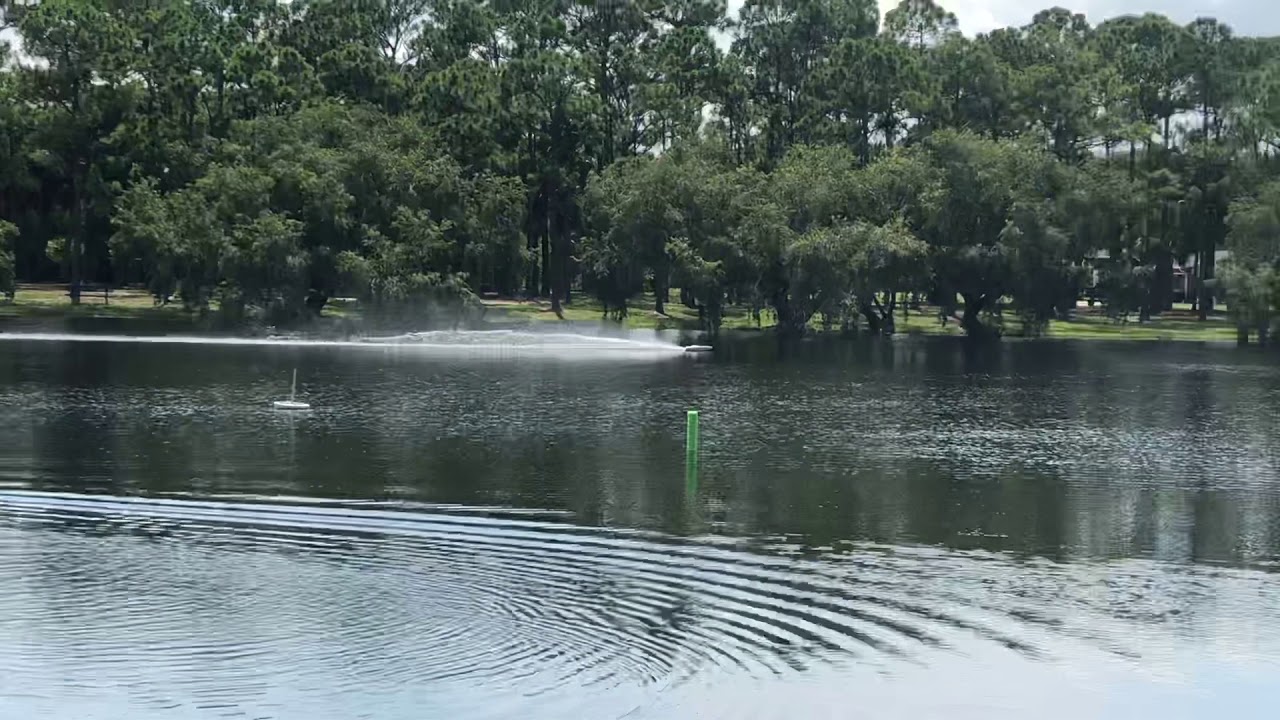

    Anyways, figured I’d share. Here’s build pics and a video. I haven’t had gps in yet so I don’t know actual mph.

    Very nice built and runs on rails!
    Congrats!

      Thank you sir. Had 3 days tuning on it. I had to start with m445, didn’t have hub spacer to get m440 on. I’d do 2-3 laps and come in. Got to put m440 yesterday and put 9 laps down on 1/8 mile, 22% left in packs, stoked!

        Did get to fun run with 5 other p limited yesterday, 1 happens to be national champ. Pretty nice to be able to compare to .

              Nice run, no chine walk I can see. Maybe more weight with more mah packs but, it runs well!

                Thank you. Been through 2 motors. M440, I run a tad slow. M445, burns motor about 3-6 runs. Detounged a x442 this weekend. Won’t know if I’m in the ball park till I run with Ken next weekend. Ran 6 today and was at 38% w/442. Not adding weight by mah. I like it light. Time to pull it all apart for paint..
