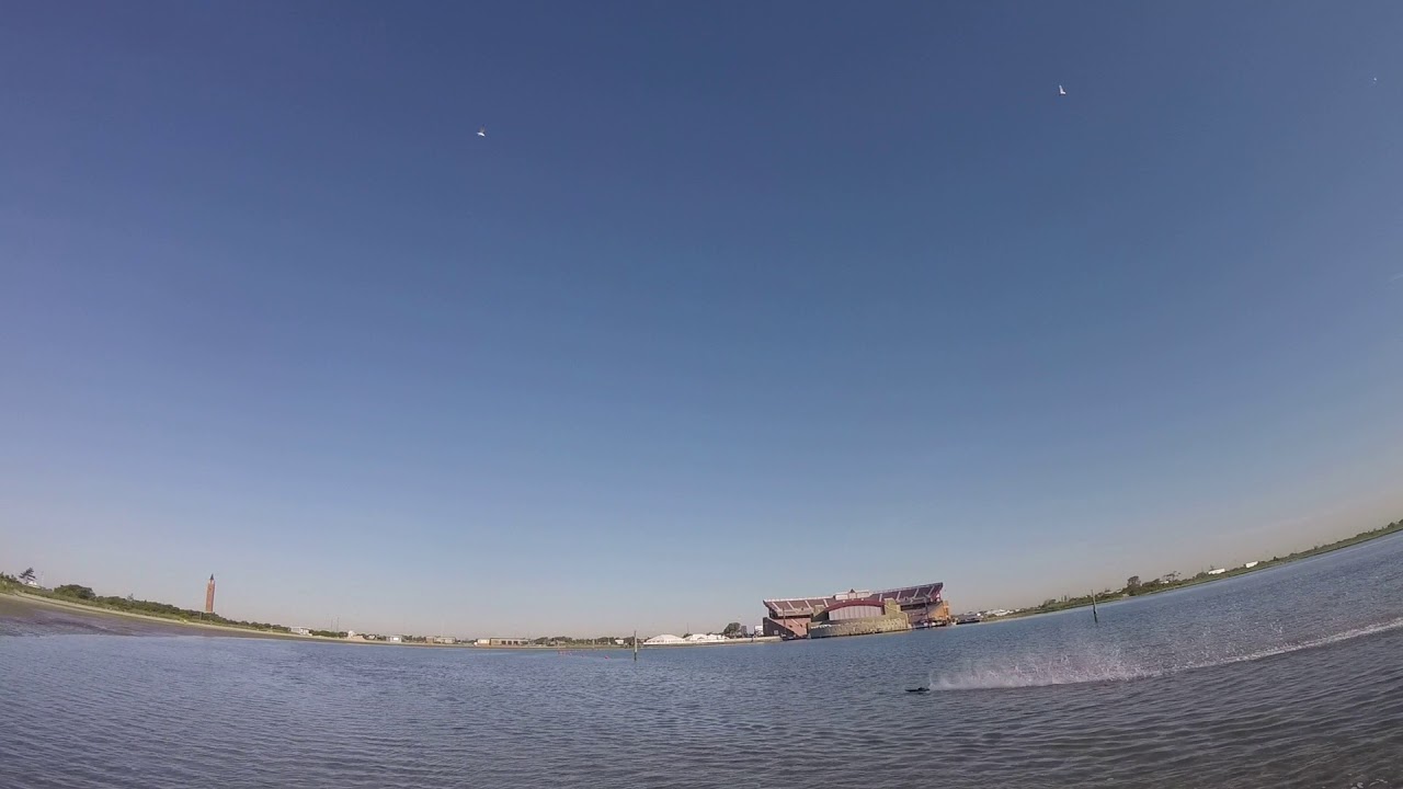

                  Thanks... I will attempt to find a better spot for the switch, however, its so damn tight in there. I only got to run it once on 4s. Didn't have a gps in it, it cavitated out of the turns, but other than that, it ran good.
                    She runs really really good. It is cavitating a lot however. I think a 1714 or 1715 would grab better and the strut is probably too high. That’s probably why you didn’t over heat things with that prop. You can tell the motor isn’t quite winding out because that prop is pretty aggressive and doesn’t have much slip once the boat is on plane.

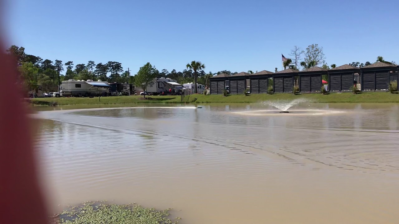

                      Here’s mine on 3s with less prop. It doesn’t cavitate, I can’t send you the strut height measurements if you want.
                        Travis,
                        Looks like you need a bigger pond. No cavitation going on with yours. As you said, I need to lower the strut. I had it level with the bottom. Maybe I will go down 1mm and see what happens.
                          Yes that was just a small pond that was convenient to me on a camping trip. That was the first day I had ever run it and I had mainly run it on 2s so it was more controllable. I went to a bigger lake and it was choppy, on 3s and scared to run it out, I got 56mph out of it but didn’t pull the trigger the whole way.
