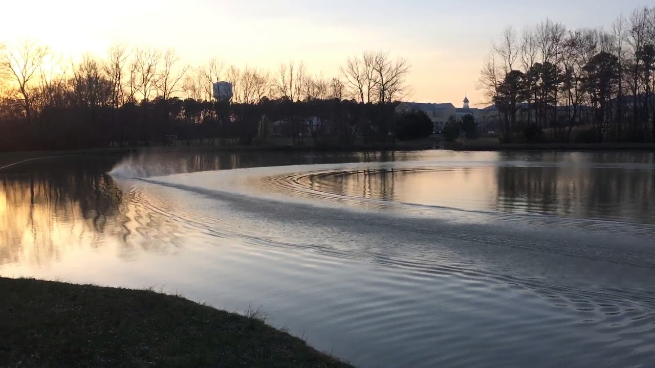

                Here is the video form Sunday. I have messed up on the turn fin angle and was plowing this boat the whole day. In the video I have a grim racer 40x57 and was doing only 64mph. Should of did 70mph no problem with the prop I used at 2700kv. Next week is are first race of the season. I think today I got the fin adjusted right so I'll go ahead and enter it and see if I can get a good video this time. This boat has way more left in it hopefully the next video will be the proof.

                  Nice for a first run.

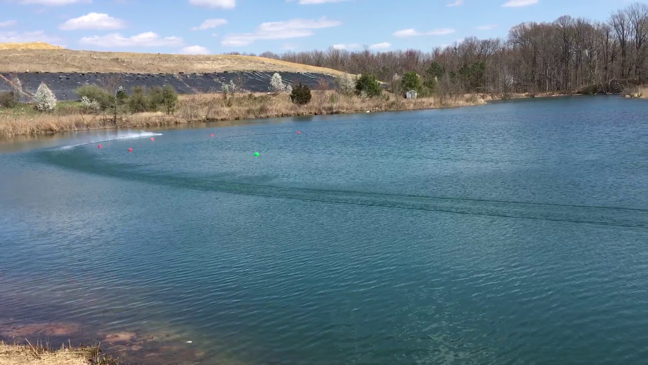

                      This is a lil better.

                        : thumbup1: Excellent!

                          Oooh yeaaah!!! Whoo-hoo! Beautiful! Rippin'!

                            Looks nice!

                              Thanks. If we don’t get washed out by the rain tomorrow I’ll get some race video.
