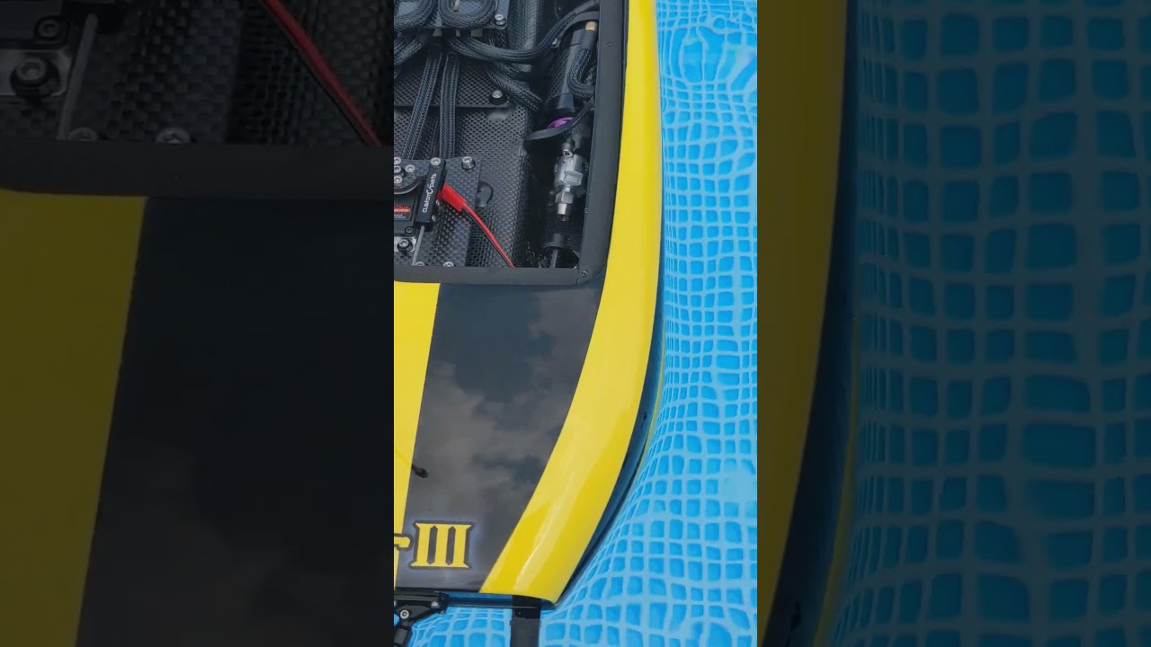

              Finished up the cooling pump setup. The boat primes the pumps after a quick spin and the remote operated relay works perfectly. This will be a big help with the incredibly warm water at the mini shootout.
              PXL_20210731_153701314.jpg PXL_20210731_154640593.jpg PXL_20210731_195321685.jpg PXL_20210731_195416711.jpg PXL_20210801_160159758.jpg
              Video of the initial pool test
