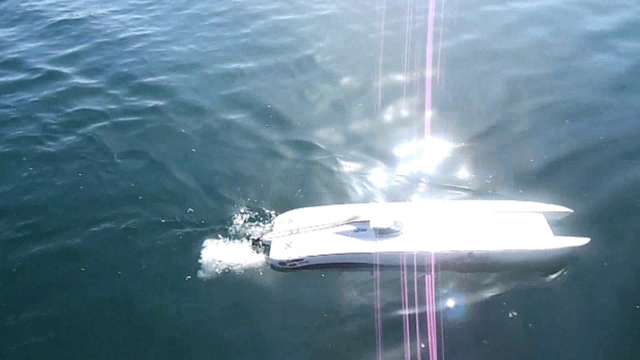

              Made it out briefly the other day. It was a beautiful day. All ran well, slipped a collet, and I think I need to teardrop the water inlets a bit. Ran a beater set of 447’s for the inaugural. I am still getting used to these dihedral hulls and there are a lot of buoys on this waterski lake. I’ll try to get more open water next time out

                  I think I had way too much weight up front. I’ll try the mid mount next time out. Maybe I can get a bit of the drunken turtle behaviour out of it at slower speeds.
                  I’ll measure the CG for future reference.
