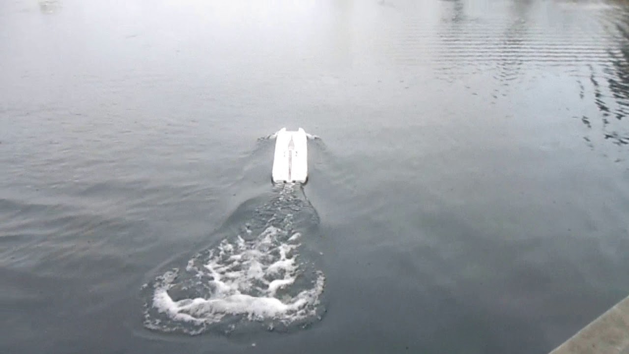

    Well I made it out again and ran the 2114 ABC’s and got a couple good passes. Then I switched to 1916 ABC’s and got a few more. Both sets of props are cut down to 47mm. My high speed was 77mph and was from the 1916’s. Pulled 220amps for 2/10ths of a second then ramped down quickly.
    Wasn’t a pretty day out there and I shook a bearing loose from the stinger again(same side), and still a pita to get on plane. Tried a tad less negative on the stingers AND some weight in the tail to get CG to 30% after these runs to no avail.
    Just sorting thru the vid
      #167
      Here is the first running the three blades: https://youtu.be/bMG3I7RMXcc
      And here is the 1916’s: https://youtu.be/Z6CCNMcoyQs
