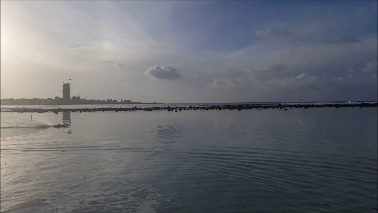

                  First few runs!
                  The maiden was a bit of a disaster; I had used normal solder instead of silver solder This lead to the shaft slipping several times until it wouldn't grip anymore. Also, as Fluid stated, the 58mm prop was way to large and the ESC kept cutting out on me at full throttle.
                  However, the hull was free of leaks and I thankfully had no problems with the bent steering rod.
                  After getting a new shaft and having it soldered properly, I changed the coupler to a better-quality Hydro-Marine one.
                  The next runs were much better! I changed to a smaller ABC 2114-10-50 prop, however I still had cut out problems. Looks like I've forgot to account for the extra amps and blade-area the ABC props have vs the Octuras.
                  Apologies for the short clips, better videos coming in the future!
                  Funnily enough, most the data logs were overwritten from bench-testing afterwards so I couldn't find any info regarding the runs The Excel readout didn't show any signs of over-current limiting, so next I'll try with shorter battery leads. Also switching to a 1914-10-50 prop.

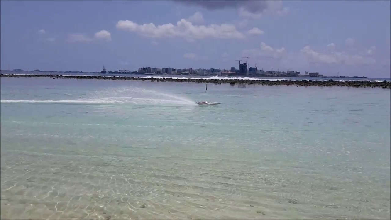

                        First successful run!
                        Eventually got the time and tide to take the boat out for a spin. Finally had a good run where nothing broke
                        The setup turned out to be really stable at all speeds. At first I had some trouble with overly-sensitive steering, especially to the left since it would hook very easily. Setting the end points on the transmitter to 60% helped a lot with that issue.
                        ESC data logs showed peak input current at 247.7A and a power output of 5400watts with an ABC 1914-10-50-CLL prop. Temperatures were on the warm-hot side on all components; which I blame on me running through the packs almost non-stop, and the warm tropical temperatures.
                        No leaks whatsoever even after being swamped a couple times thanks to my reversing skills
                        GPS speed was somewhat low at 80.6km/h (50mph). I had the strut set all the way up for this run, so planning to lower it for next time and see if that helps with the acceleration and speed.
