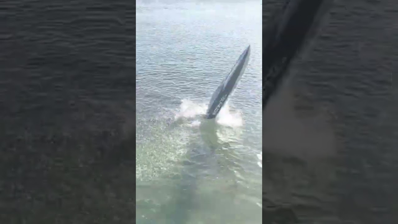

              I haven't really been keeping with updates, but man has this boat been a series of weird events, some of which were admittedly self inflicted.
              The minor stuff...
              • One of the lights blew out and left a nice pickup port directly into the hull.
              • The port drive shaft got somehow hooked and had one loose wire that I ultimately had to grind off.
              • I really need to work on a better way to seal the hatch. I'll try a thin foam as well as build up the hatch lip a little. Tape works for now though.
              • I'm also still getting a little drip through one of the strut mounting bolts, nothing that can't be fixed with a little silicone.
              • The rear bearing in the port strut somehow came out. It's a very loose fit. The flex shaft is short enough that I'm not worried about much shrinkage, so I just left a little less of a gap. I'm going to try to just find new bearings for both struts.
              • I really need a proper marine receiver. It's not too big of an issue, but playing in salt doesn't take much for it to start spazzing out. Taking the receiver apart and cleaning it with a brush is part of my cleaning ritual.
              THE BIG ONES...
              • The motors just can't take it. Two passes and the outrunners are way too hot to touch. I ran the CNC M4616 for a single pass, but even the CNC X4514's are too much. They sound really cool, but I already got the 1600kv 4082 inrunners. Unfortunately, a buddy needed a new motor for his Spartan, so I just gave him one. Plus I didn't get 5mm shaft coupler anyway so that's kind of that for now.
              • It really needs turn fins.
              • My soldering iron handle broke so I can't even try out my larger and fresher 6200mAh 65C 6S pair. The 10yr old Turnigy HD are still hanging in there.
              Sorry for me cackling. Today was honestly the first of the four runs or so that I've actually just had fun with it.
              Also Sorry for the vertical video... I swear it's youtube...
              The motors I got are branded MSQ from Aliexpress. The seller was actually really cool and reached out to me wit production updates since they weren't in stock when I originally tried to order. The one that went in the Spartan is running as cold as the surrounding water. I figured it would be a bit much for the stock ESC, but there is zero heat. Now that's running only a 42mm prop. We did try a CNC X4514, but ran into other issues with the boat. Even with the limited runs, there was zero heat. I have no reservations about sticking these in with the larger 46-48 props.
