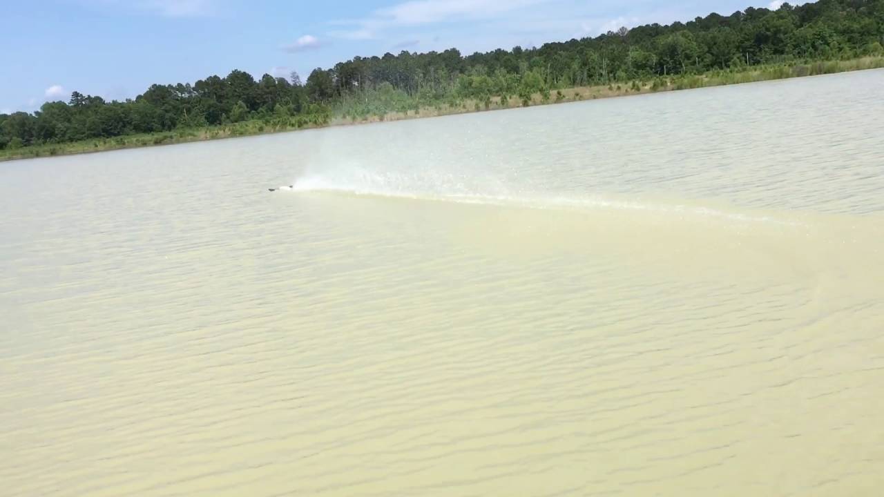

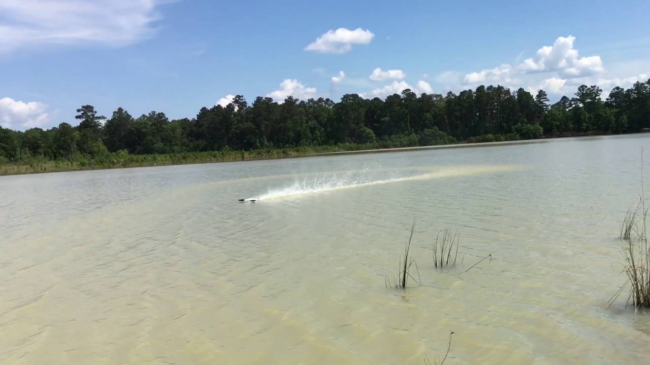

          Maiden on 3s
            And on 4s. This was with an x438 prop
              I did get a gps reading on it later that day. I had changed props which it went slower but run much smoother. It did 51.2 but it needs some dialing in. Should easily go 70 dialed in.

                        Here's a newer video from last Sunday. I made some changes and it went almost 60 at this point. It's swelling the battery right now so I need to rethink my power soup and maybe prop. The motor and esc don't even get warm so I think I'm just not running enough mah. I'm thinking about going down to 3s with a higher kv tp motor and 1000 more mah.
