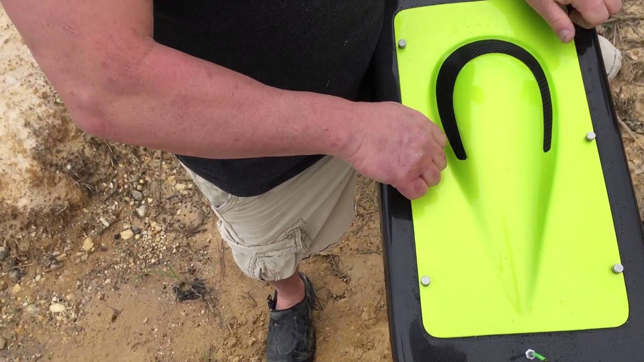

Tape up area. Position. Mark holes with sharpie. Drill pilot hole. Then drill to size. Only one hole. Drill bit can walk. So I then keep checking by putting a screw in the hardware and go from there. I've also double stick taped hardware to hull and drilled the holes.
I prefer flexes. It's what I know. I'm starting to make my own. My bends are to much for wire anyway.
Stuffing hole. Mask off. Position motor. I have a .187 stub goes in collet. To help mark location. I have a large digital caliper to make sure the hole is in the centerline. I drill the hole within .002 of true center. Drill pilot hole. Remember the masking tape...incase you slip too. Then I have a tapered bit that is marked, I drill to the mark. Two holes. Connect the holes with a Dremel cutoff wheel. Then a small sanding roll on the dremel to finish it off. If it's not perfect don't worry epoxy will cover it. Then I have another .187 rod that goes in collet. Couple piece of brass sleeve that sides over to center everything.
