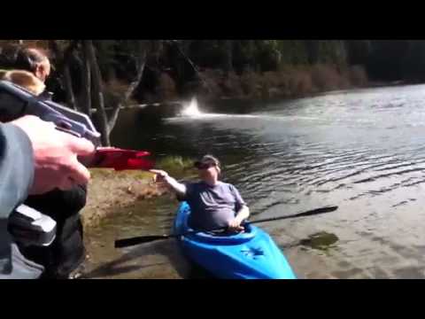

    Here's a cruddy video of my second "first" run a couple years back, with commentary provided by my son and the rest of the crew on the lake. I never fixed the hopping problem, and I took on some water knocking out the RX, but you get the idea
    This is NOT a toy?!?

        what size prop did you run
            This run was a m447.
