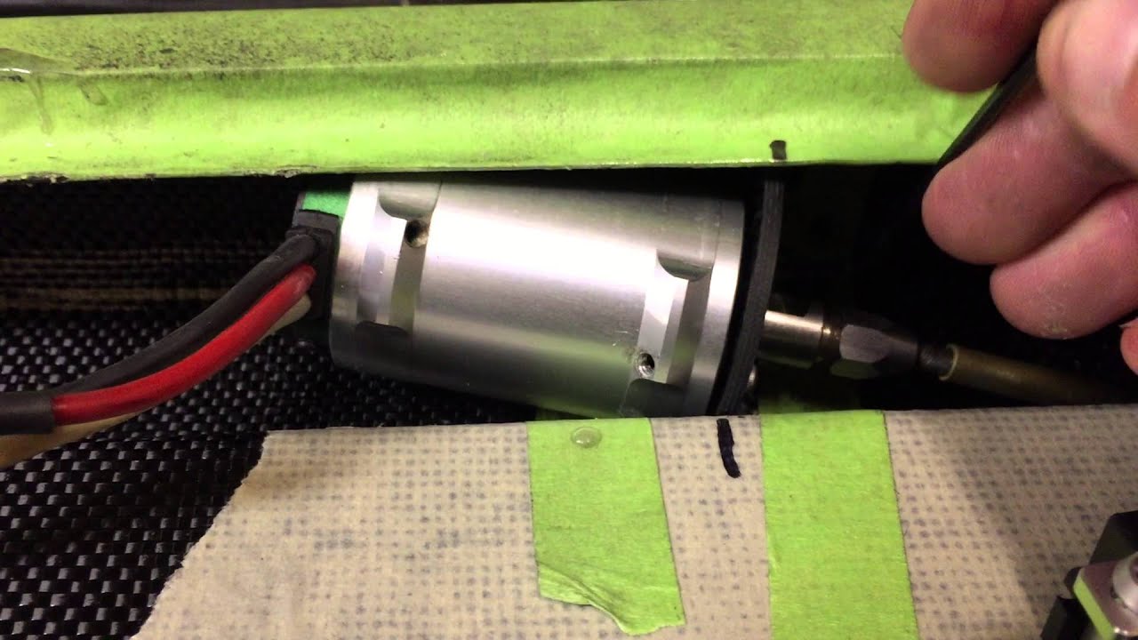

Man I have some awesome motor mounts. They are twist slotted. You loosen the screws a touch and twist motor and come right out. Easy.
I could not move the motor any further back because of the motor length and angle. Where it's at is as far back as I can get it. I'll figure it out. I have some ideas and I also know what the Cg needs to be on this hull.32" carbon rivercat single 4s 102mph, 27” mini Rivercat 92mph, kbb34 91mph, jessej micro cat(too fast) was
Originally posted by RCKong View PostI see what your saying. do you build the motor mounts ? i like the twist out mounts but not confident enough to make the slot and mount hole right.
I had Monojeff make them for me. I'll post a pic of the other. I have a template to trace if I ever need to. Once I get my cnc up and running (yea I still haven't fooled with it, been too busy) then I'll make a file for them.32" carbon rivercat single 4s 102mph, 27” mini Rivercat 92mph, kbb34 91mph, jessej micro cat(too fast) was
