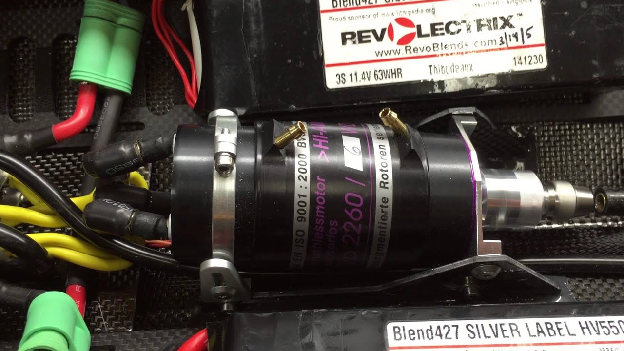

                Pecked away at it last night. Got the trim tab situation situated lol. I made some little aluminum threaded plates for the screws to catch just like rear wheeling suggested. Worked perfect.
                [URL="[URL=http://s218.photobucket.com/user/ltzguy/media/6B5B7E1B-5A66-4E59-8C00-2BF23B3B3DD3.jpg.html][/URL]"][URL=http://s218.photobucket.com/user/ltzguy/media/6B5B7E1B-5A66-4E59-8C00-2BF23B3B3DD3.jpg.html][IMG]http://i218.photobucket.com/albums/cc243/ltzguy/
                And I got it all wired up. Tested it. Everything is good to go.
                [URL="[URL=http://s218.photobucket.com/user/ltzguy/media/AEFCBB94-0EE1-4596-B984-96C7AE313C82.jpg.html][/URL]"][URL=http://s218.photobucket.com/user/ltzguy/media/AEFCBB94-0EE1-4596-B984-96C7AE

                  #68
                  Watch now that's the way your going to start do-ing it now ! lol I use to do 4mm taps but switched to 3/32" , much better now.

                    #69
                    I did these in 3mm x .5 because that's the screws the tabs come with.

                        #71
                        Sorry Travis I told you wrong . I meant 8-32.
