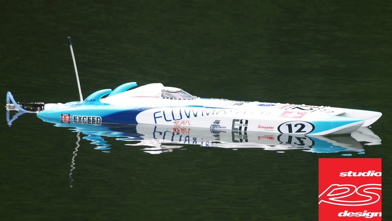

          And finally a video of the maiden.
          In the video, I used the stock 432/3 carbon prop, stock 4mm flex cable and shaft.
          I have a 436 CNC and 436/3 TFL (needs balancing). Might try these both.

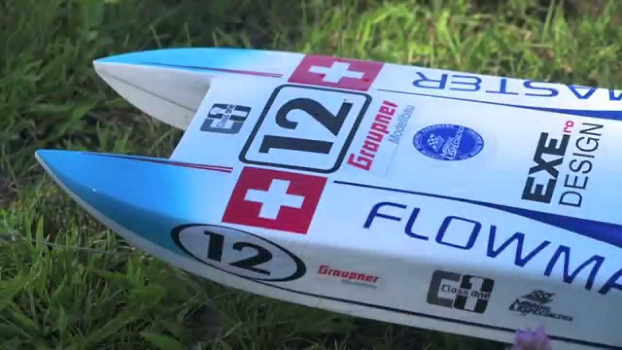

                Thanks! Just need to pull out all the blue flotation foam and add CF/Kevlar epoxy to the sponson tips and front area. Don't want to have this happen if I catch a tip WFO…

                    @Davey80 - Thanks! There was only one item that I neglected to fully address, getting enough epoxy down into the sponson tips, before adding the flotation foam. I did add some epoxy, but could have added a little more. You don't want to add too much weight though. The CF reinforcement definitely helps, just keep the epoxy application light.
                    It's a fun little scale hull and certainly fast. I was about at the limit with power and battery, as you can see in the video, the torque roll was significant on full throttle. I've since sold this on, so can't really help out with further performance tuning.
