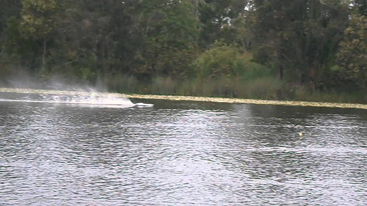

          Well I think it was a successful day at Sippy Downs yesterday.
          After a couple of flips, some strut depth & angle adjustment, and some prop changes, she was running pretty good in a straight line.
          Cornering is a different matter. The turn fin at the heel of the front shoe certainly helps but at fast speed the inside sponson would lift & the boat rolled over. So it definitely needs a fin on the right sponson somewhere.
          In the videos you will see that I had to back out of it in the corners to avoid the rollovers.
          Ended up with an X450/3 prop & everything was just luke warm after a run. So an x452 /3 is next on the list.
          I left the batteries at the front, so Ray, your instincts seem to be right.
          But next time out I'm going to move one pack to the rear section & try that. If the front wants to lift, I'll add a bit of negative strut angle to compensate.
          If that doesn't work then both packs will go back to the forward position & all other adjustments will work around that COG position.
          I'm encouraged enough to go ahead & give it a full paint job now.
          There's definitely more speed in it yet & once the cornering is sorted out it will be a great boat to run.
          Here's some pics & vids of its first 'full' test day.
          I'd like to thank everyone here for your help, insights, knowledge, & words of encouragement on this little experiment. It's all helped to get this thing on the water.

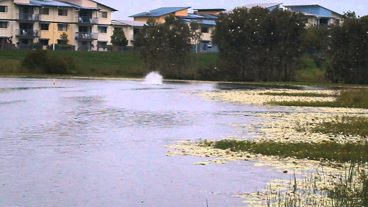

            Another video. This time from the end of the front straight.
