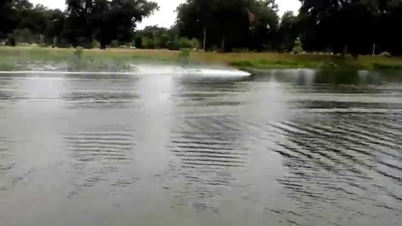

    Ose has them. It's a 1915-17-45 two blade. 17 degree rake. It really like these props much better than a 447 and 447/3. Strut level, lifts the bow perfectly and the ride attitude is perfect. Hers a video of it on 7s. The first was 6 s. The whole point is I'm showing Darin there's no need for any silly ride pad mods. With the right props the boat will run quite well.
      Thanks kfxguy guy, will try one out.
      I didn't mod my rear sponson either "glass hull" it runs awesome wide open around ovals but always looking to try different props.
      Ps that's one fast cheetah!

        Well my goal was 70. It's called a cheetah, right? Well it better live up to the name. This one does...it's been 88.8mph. Lol.
          Haha, we'll if you put it that way I have alot of catching up to do
          Those are some impressive speeds!
          Farmer
