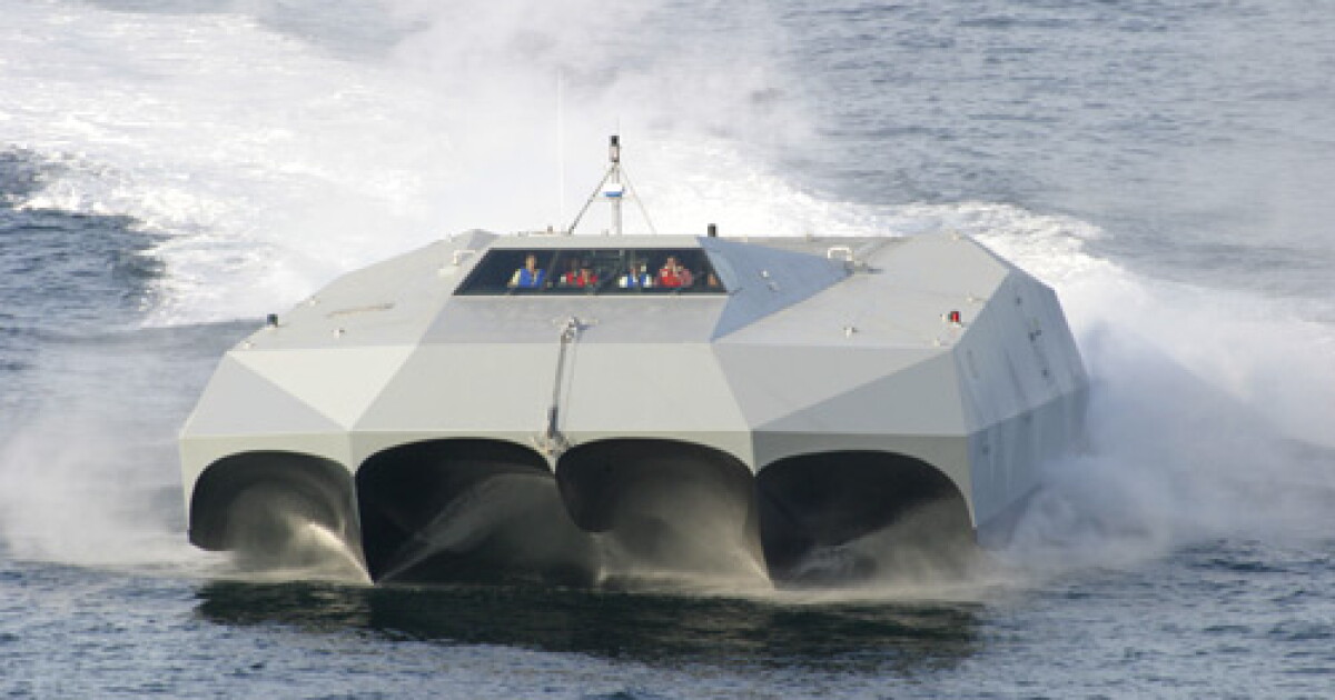

    I've always wanted to build an M hull boat since seeing the Stiletto concept M hull design some years ago.
    February 5, 2006 The M80 Stiletto Experimental Vessel was launched this week offering a sneak peak at the next generation of military vessels. The Stiletto is an operational experiment by the Pentagon’s Office of Force Transformation (OFT) and its revolutionary carbon fibre structure and hull…
