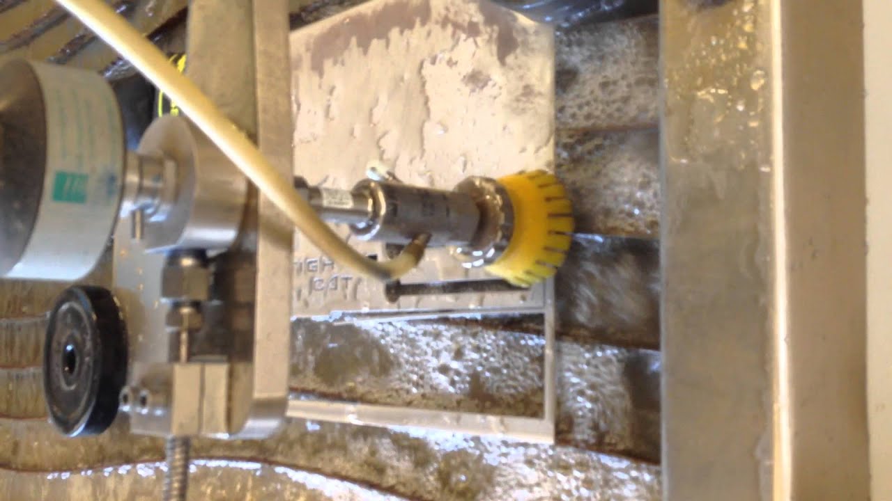

                        I have some new skilz!
                        I can Waterjet!!
                        This is a test of a battery sled design I made.
                        I like the results enough that this thin aluminum plate will end up with the same polish and powder coat, glue it to CF plate as structure.

                          I flippin LOVE TechShop Detroit!!
                          I used the water jet for some more parts.
                          A FighterCat logo out of Aluminum,
                          Transom Plate out of Aluminum
                          Battery Trays out of Carbon Fiber
                          I then polished the aluminum parts, and gave them the powdercoat.
