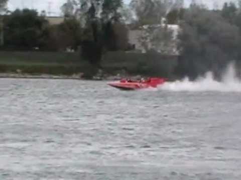

        Great videos. I enjoyed watching both of them and especially the second one , that was some rough water! I love waiting to see you hydro turn at the right side of the screen full throttle , it's like running on rails but you know she wants to slide just a little only if she gets her way, that turn fin is doing its job, and how!
        More importantly, it does look like you Australians are having more fun, I am going to get a stick and may be I can pretend to have more fun at least!

          Thanks Tim.
          Yes , the turn fin works well. A bit more tweaking & a few more props to try & it will be ready for racing.

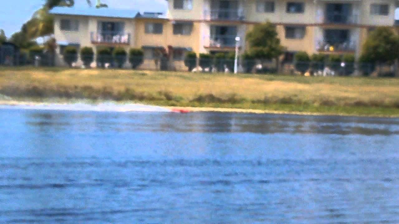

            I'm looking for a bit of help with the layout of gauges in the dashboard of these hydros if anyone knows. Just an idea of what they were from left to right in the attached pics.
            And here's a bit of a run at Sippy Downs yesterday with an s240 prop. Things were a bit on the hot side even for my 'touchy feely' standards. I don't use a temp gun. But the guys around me know, that if I say something is a bit hot, it is a bit of a worry.
            I'll take a millimeter off the tips & back cut it a bit & see how it goes. Then I'll start playing with the strut to tune it all up a bit to get rid of the tail hopping in the corners.
            Sorry it's a bit blurry. Don't know why.

              I wish mine sounded like this.

                Holy crap Paul, I need to get,on the computer more. Its running real nice! Flat bottom strut? If so, try a round bottom, and deepen the strut 1/8"...Try an X series Octura as well. You are the first one to run one of my ML Lauterbachs!!! Congrats on the great build!

                  Paul, very nice brother...Yours has a sweet sound all its own...I can tell Mike is proud too....gotta love the thunder... DJ

                    Thanks Mike.
                    Yes, She turned out ok. It was certainly faster than I thought it would be in its first runs. Plenty of props to try yet.
                    It is a round bottom strut. It does look like I'll have to drop the strut a bit. But I might try moving the weight forward a bit first.
                    DJ.
                    That noise was a loose prop nut. The prop was vibrating on the dog. So we found out when it was back on the bench.
