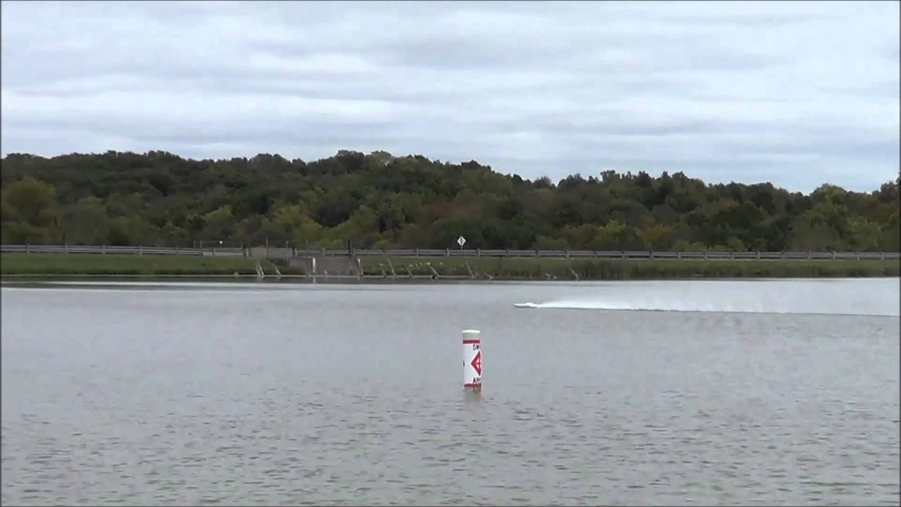

            It's hard to say without seeing it, but the pre-plane behavior may just be a condition of the hull design. A lot of people are concerned the first time they run a MHZ mystic or HPR Tencara style hull because they're tough to drive until you get them up to a decent speed. It's just an effect of the dihedral sponson design and low amount of lift at low speeds. The sponsons will "rudder" the boat until they really come up out of the water. It's not the best demonstration, but you can kind of see it when I take off in this video. Notice that a throttle it enough to get it to leap up out of the water...otherwise it's almost impossible to steer it where you want it to go.
