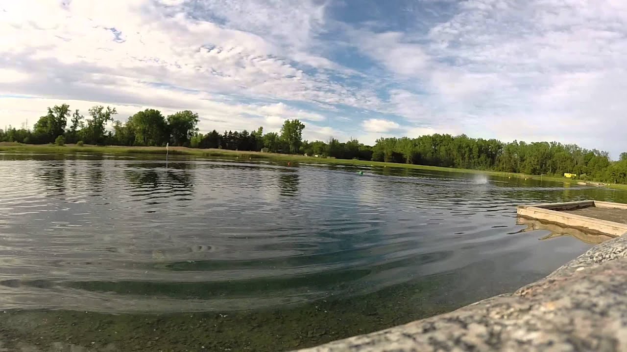

              Went out last night, but no cameraman so I set a GoPro on a big rock just to get a few 3s passes in. The batteries are run down just a bit in this video and it's running a little wet...but you get the idea. Next time, fresh charge, I'll air it out a bit more, and hopefully have someone to record...

                The little one is looking good Joel. Real easy to put in the water too.

                  Nice Joel....small but fierce!

                      looks and sounds fast. really nice joel its amazing to think its only 25 inches long.
