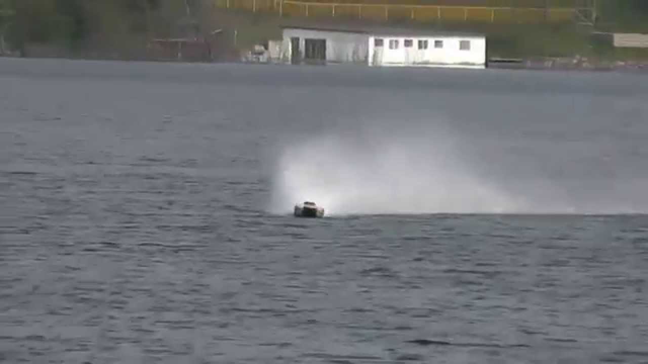

      Just a short and slow maiden drive video...

            Once you get some air under the hull she will handle turns unbelievably well.
            This is a beautiful build and will surely give you a ton of enjoyment this summer!

              Yes, I have noticed that...more slowly I drive less my rudder inputs have effect on turning...and also, when I turn at low speed she leans to one side much more than when she goes faster...probably that's because...when you drive slowly more boat mass is under the water...and also, at slow speed less water runs by the rudder so turning action is lazy...correct me if I understand that wrong.
              But I was terrified when that huuge thing went into water...that has to have 30 kg with batteries...and I was driving veeeery slowly and with care.
              Next time I will go a step further...
              I am always very careful first time...and I believe that is a good practice. Every time I overlook something...for example this time one coupler was loose ...and on other shaft my prop was also a bit loose...so I am careful because I know myself. That's like I'm giving me a second chance to fix everything I overlook for the first try

                                Scond test run...this time no more loose couplers...
                                Very windy, choppy water...that was a bit difficult. But, the worst thing was...many kids came to train sailing on the lake, so I had to be very careful...and that is complicated if you want to test speed with an almost 30kg boat that goes fast like a lightning...
                                run time...cca 12 min
                                Fastest passes...1/2 throttle, no more. Runs cool. Batteries temp OK, motor temp OK, ESC temp OK. Props 6518/3
                                here is the video:
