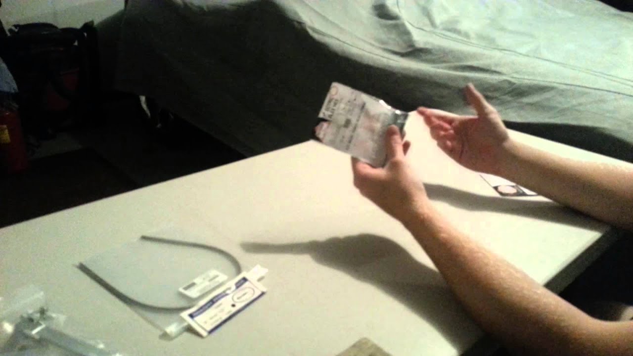

              Part 1
              • detox
                • Jun 2008
                • 2357
                Nice video. I have ran the .187 cable with and without liner. I like using the 1/4 stuffing tube with no liner best.
                • jfrancisco892
                  • Feb 2012
                  • 593
                  Thanks for the input!
                  • longballlumber
                    • 3417
                    Nice Job!
                    I think your right that 3/16 cable is the way to go. However, I would advise against the Teflon tubing in the stuffing. I am not convinced it offers any positive other than more parts. I would stick with 9/32" sleeve epoxied and glassed into the hull and the 1/4" as the stuffing tube (no liner). They have been using this system for MANY years. It's bullet proof. Just my 2 pennies.

                      I suppose we will have to agree to disagree. I talked with pete and he had some good tips on how to secure the liner so that it doesn't spin up into the collet. I also don't like the idea of the flex cable having direct contact with the brass tube. It seems like a lot more friction that is averted when a teflon liner is used.

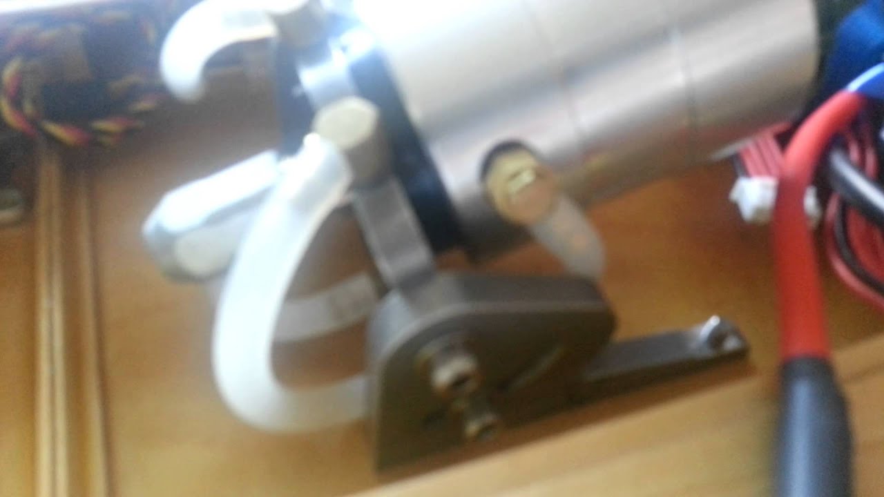

                      Just as an update, I got the strut, rudder, and motor mounted this weekend. I didn't have time to make another video but I will do one in the near future. I am going to have some machining done on the motor mount to take off 1/8" off the bottom to lower the cog of the motor. After that I'll do a layout of the boat to determine how I am going to bend and mount the stuffing tube. After much debating I am going to do a "J" bend as opposed to an "S" bend. This is a bigger debate on this forum than pro choice or pro life, but that is what I am going to go with. I can only work on the boat on certain weekends because I work on it at my parent's house and I work away from home, so I probably won't get any more stuff done on it until the 14th.

                            Part 2 Finally.
                            • detox
                              • Jun 2008
                              • 2357
                              S bend is doable, but more work and unecessary. Just use single bend with minimum angle with good adjustabilty on the stuffing tube. I am sure you are mounting ESC next to stuffing tube. That is where i mounted (loosely) my Hydra 240. What prop are you starting out with? You may need a little tongue on prop to get that heavier P sport on plane quickly. Slight Cup on prop tips will get her going fast. I also raised and widened my ridepads because of heavier 4s2p weight.
