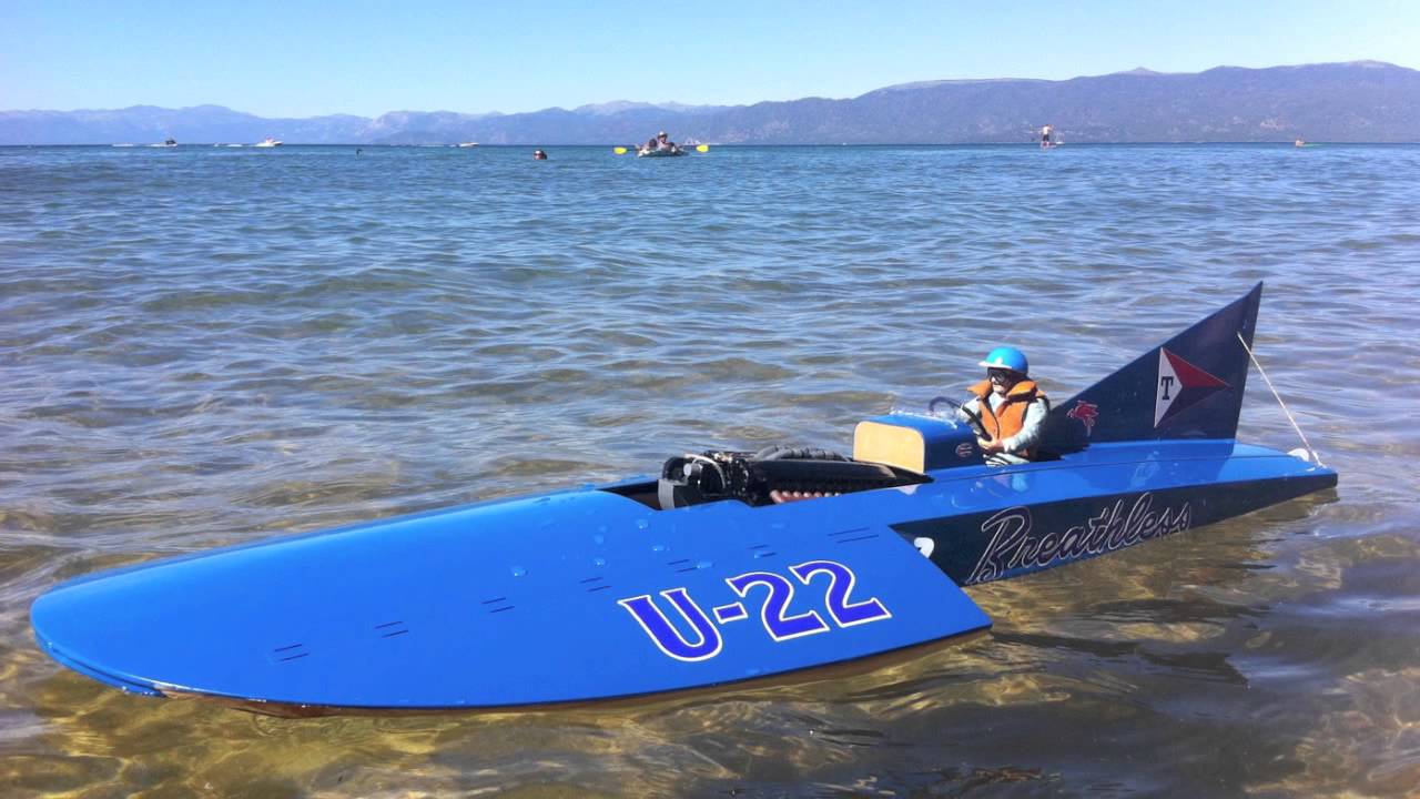

                I was able to maiden this at Camp Richardson pier in Lake Tahoe. I designed www.classichydros.com website and totally forgot to post the video in my build thread. On to building another 1/10 similar later year shovel nose.

                • eric_laermans
                  • Nov 2010
                  • 96
                  Nice build, but does need some trimming for better speed/ handling IMHO. I guess if you move the CG more aft, it can handle more throttle easily.
                  • studioRS
                    • Jan 2009
                    • 116
                    Yes, currently in for a repaint to tick lighter blue. Also working on other Octura 447R props and weight distribution to the rear.

                        • leonard feeback
                          • 130
                          Hi, nice job on the U-22 build. looks like the boat is porpoising. Try taking a little of the tips of your prop, that should take a little lift out of the prop. You don't want to get a lot of weight on prop to fix the problem. That will make the motor work harder which meant heat. You may have to move the strut up a little toward the bottom to fix the problem. You want the middle of the prop shaft at the back of the prop to be the depth of the sponsons at the air trap side.

                              • studioRS
                                • Jan 2009
                                • 116
                                Yes, thanks for the kudos and ride tips. Currently hull is out for repaint to lighter shade of blue and have several props ready to wake the Breathless U-22 up again reducing the rear prop weight and hop.
