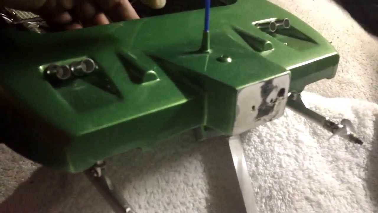

              I did some work last night. the water jackets came in the mail so here is what I did. first was to install the new motors Leopard 4074 2200kv. Then I installed the saddle to mount the new rudder that I pulled from my Genesis 1426mm as I have a bigger one on the way. So this rudder is a 150mm and should work well on a 42" hull. It doesn't have a water pickup for cooling so I drilled holes in the bottom so that water will come in. I also mounted the servo in a new position so the servo works up right. the build should be lighter as well cause I removed the battery and servo pan that would never stay in place ( welds always broke loose).
              038.JPG040.JPG[ATTACH=CONFIG]103601[/ATTACH032.JPG
              I used 2 part Gorilla epoxy on the hardware that you see in this posting.
