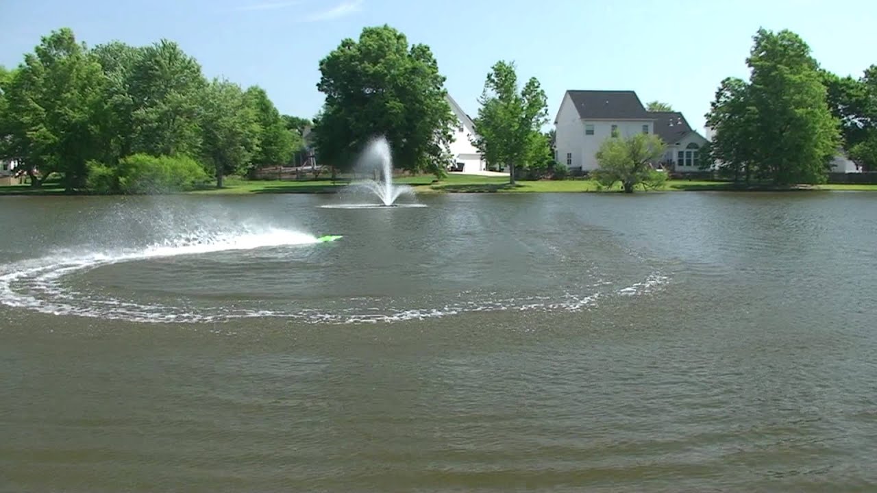

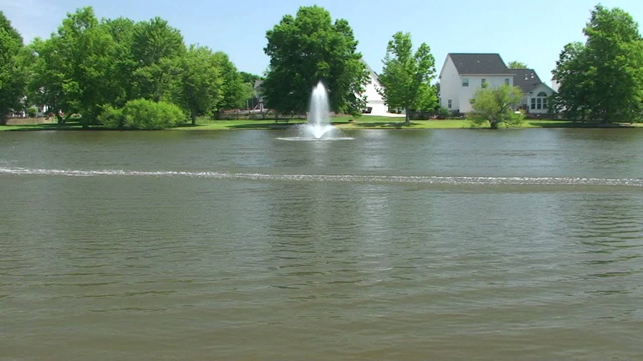

    Videos of Rico ...sorry I forgot the wide lens ...on 6s at times it looks with a blur across the focal area. I have the 4s video to slow it down and show the turns better ...if there is any hop it's from waves.
    4s2p 5000mah ---too heavy but it will run wide open for 6mins and everything comes back cool ...great for my nephews who visit.
    6s1p 5000mah with dead weight about 5oz. and trim tabs down 3 degrees ---comes back a little warm (will be raising tabs a little)

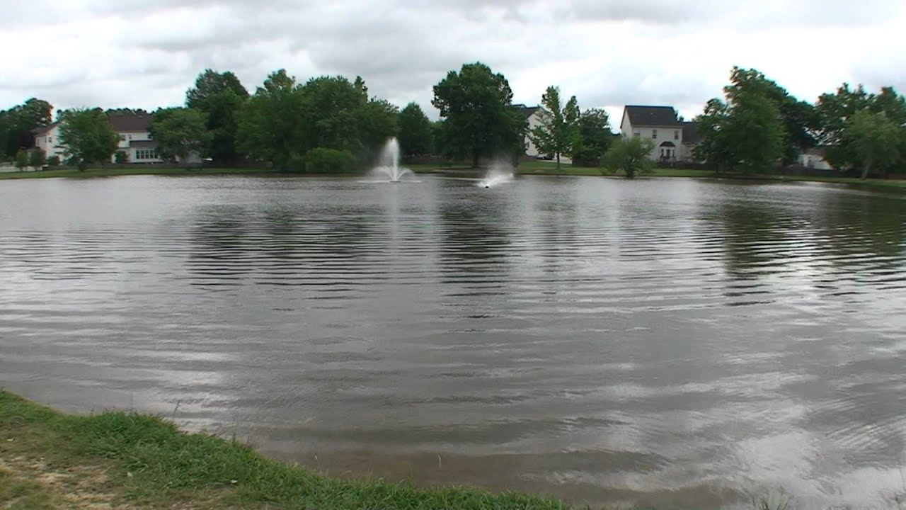

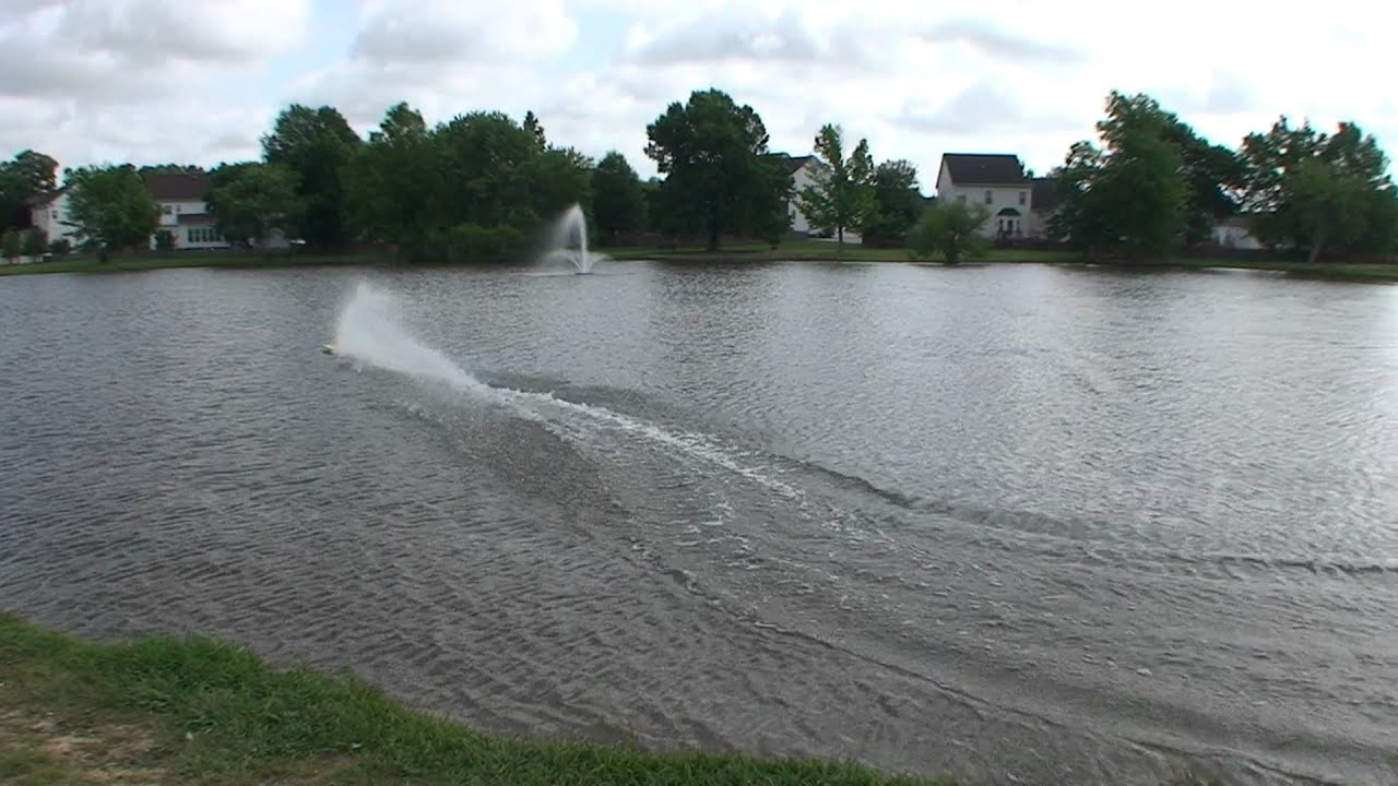

                I ran the boat yesterday morning and was pretty happy with the setup. The x447 didn't work at all....the boat was hopping like a rabbit. The m445 ran well. CG was good using the battery tray placement. For 6s2p I moved the packs back and hung 5mm off the rear. The tabs engage really well and I noticed that when I adjust them down it smoothes out the turning and took away a little hop. The 1717 motor got warm but kept the battery/batteries cool and the T180 cool. In comparison this is opposite the Rico, where the Castle 1520 stays cooler, the T180 is warmer and the battery can get hot. The run time was amazing ...I attribute this to only being at 80% throttle ...the boat seemed to get loose above 50mph when hitting a little wake and its hard to know when that will be. This brings me to the terrible news. While 6s1p is very fast ....after about an hour of short runs playing with strut angle, trim tab and CG I had her running good enough I thought to try to do 8 laps around an oval course to check run times and temp ....thats when the boat caught air then dunked The hatch flew off, the boat filled with water, and floated nose up. Guess what, I didn't have hatch floatation, so it's at the bottom of a nasty pond filled with geese crap, green slim and fish hooks I spent yesterday evenning inpecting, taking everything apart and drying it all out. I can definitely say that West Systems Gflex epoxy is the sh** nothing came loose. Now for the hatch locks ....they are very nice looking and a good product in theory but I have two reasons I will never use them again. 1st. the little pin can become uncentered after you have locked down your hatch and you will be out at the pond and find you can't get the hatch lock to release and now your hatch is stuck on ...the fix is to use pliers and twist until the aluminum above the pin breaks. 2. This episode where I lost the hatch was from the top flange(the part that gets glued on top of the hatch cover) completely breaking away, as shown in this picture of what's left. I think I'm going to use a nylon body post, rubber washer and body clip ...since I also have experience smashing 60mph oval track cars into concrete walls and never had this combination fail. I'd love to see some examples of what you guys do and what just plain works. 002.jpg
                Drum roll ...here's videos! I really want feedback ...do you think I can get it to handle race water at 50mph? Jeff at Insane Boats told me about a guy on here that added bondo fiber glass resin to the underside back edge and it has allowed him to do a 70mph pass ...Properchopper, what do you think?? I'm open to moving the tabs in, though they seem to work just fine, possibly shortening or raising the strut. I hoped for this to be a boat I can race in choppy water ...it's good now with the 6s2p setup at 11lbs, running wet. I hope to try to add like 12oz. of lead with 6s1p. and see how she does through the chop.
                6s2p with m445
                6s1p with m445 with dunking at end

                      Rip,
                      Although my main experience with IB34's are with 4S2P setups, with a rtr weight of @ 9.5 lbs, I can see that your boat is running stuck to the water. At 11 lbs with 6S, the boat needs to break loose - guaranteed racewater will do this - even my 4S2P setup sticks on smooth water. You'll definitely go faster with 2P but weight is a factor, so run in chop & you'll see a difference
                      Mark F's boat, the second one out of the mold [the one Jeff mentioned] needed to add some material to the rear edge (so did I - mine was the first out)
                      The later, shorter strake hulls are ok in that area. In fact, Mark's newer hull is unreal with a 1527 on 4S but any hull could use some blueprinting - I'm still working on mine.
                      If you aren't getting chine walk your tabs should be OK where they are, but as you increase speeds and the hull airs out things could and likely will change.
