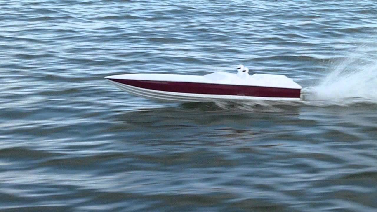

                            This is an old thread but wow, that boat was fast for its size. It turned really well too. Looked like a mid 30" boat racing around the pond. Hard to believe it's pushing 50" going 50+mph.

                              50 mph in a 50" boat is not hard to achieve but in my opinion best bet is twins,for instance a friend over in Finland built one of my 58" Apache (Navaho version) hulls using twin t 600 880 kv motors on 6 s and he was getting 50-52 mph,hes since switched to two himodel outrunners 910 kv motors on 6s and speeds arround the same maybe a tad more,she runs awesome.
                              Whats more impressive is hes only using cheap hobbyking 200 amp esc,s so this build wasnt expensive and it runs flawlessly.

                                That is a sweet running boat! Cuts through the chop so easy
