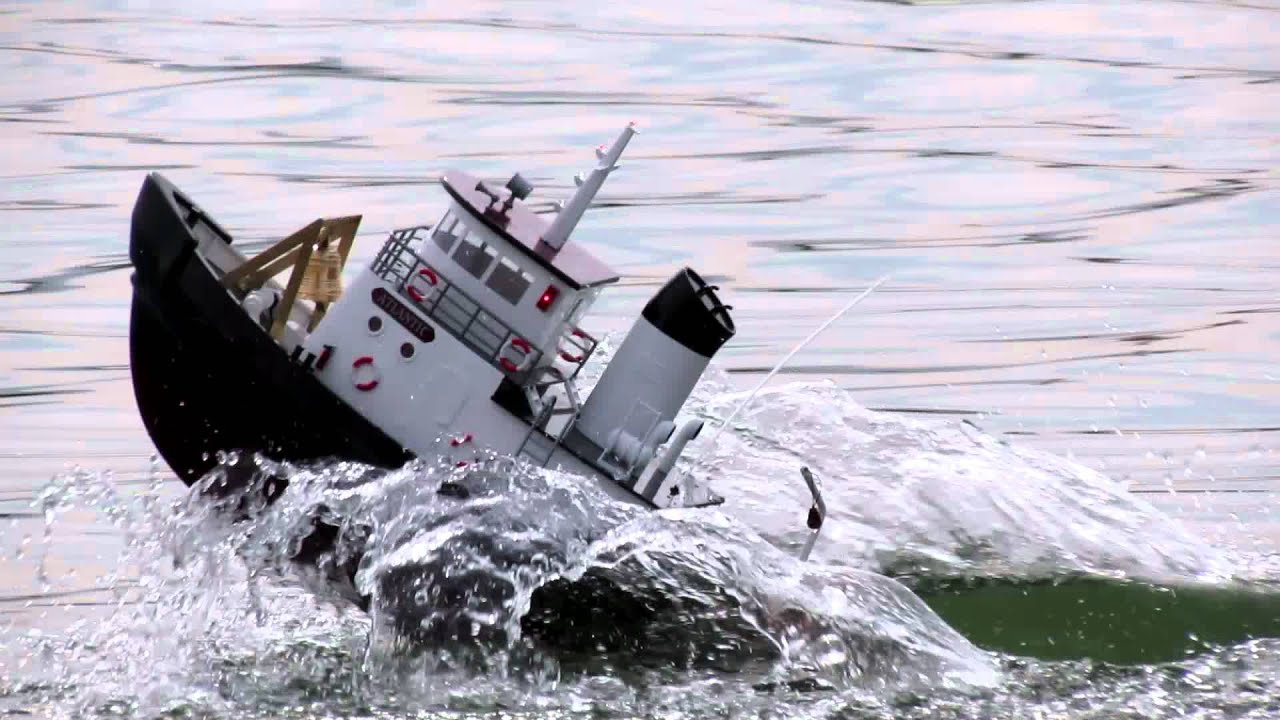

    This thread is pretty dead but I figured I would update a little. I bought an Atlantic Tug I (early version) for a rescue boat. Boat is awesome. I run a Flysky GT3 2.4 radio. Novak 55T motor a modified Raboesch 35mm 4 blade prop and a 1040 esc which is good but doesn't have crawler mode so a 1060 would be better. On 7.4v lipo, with the 55T motor and stock prop the boat has the exact speed as a version two on 11.1v. The 35mm 4 blade which needed to be cut down a touch has quite a lot of pulling power. Run time for 90 minutes consumed 1340mah out of a 5000 mah 7.4v battery. I have not tried it on 11.1v yet but temps on the motor using the 7.4 lipo were 68* degrees. You can use the boat for rescues using the drag line method or making a pvc/fun noodle H rig. Both work really well as the Tug boat turns on a dime. The boat is really enjoyable and very relaxing to play with.

            Well I used mine for a few trips to the lake as a rescue rig via tow line and tennis ball. Just circle the upside down boat and grab the rudder and tow her back to shore. I actually haven't used it in over a year now but looks great sitting on my shelf lol. I think I'll make a pvc noodle rig for it. The stock shaft is probably the weakest link imho. Now I wanna take it out and play with her next time I head to the lake re reading this old thread. Lol.

                I have two of the Tugs one for me and one for the wife. No problems from either and they are super reliable. Slow rpm motor so basically nothing wears out. Top speed about 10 mph and run time over an hour on 4000mah. I use it for fun and as a rescue rig with my fun noodle recovery set up.
