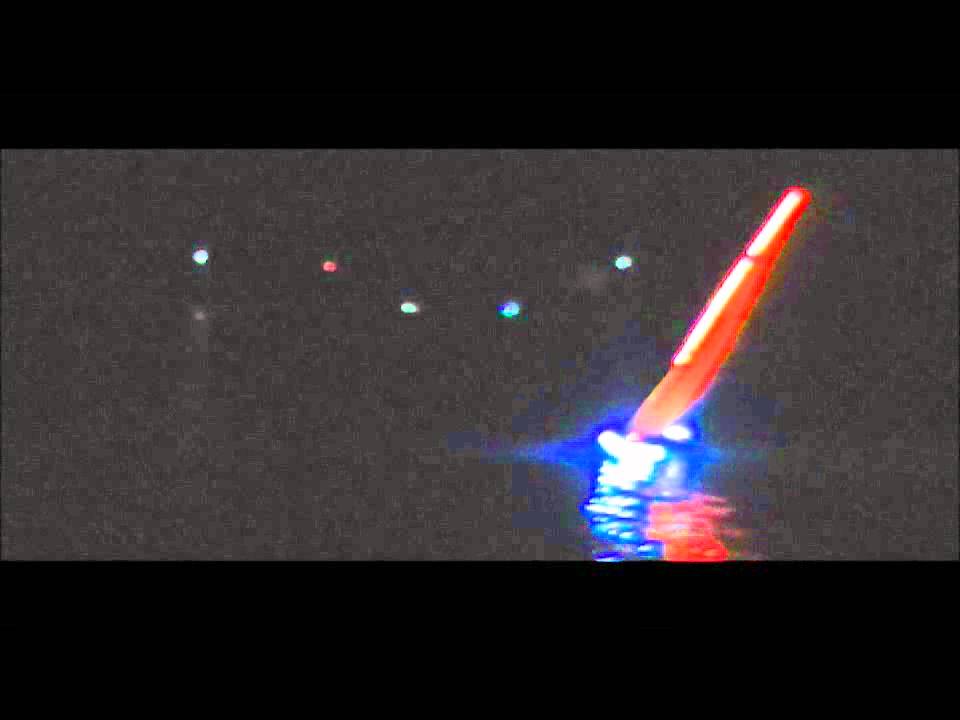

                  I'll post a video of our new yachts light's as they float around over the cool winter nights. I'm planning on fitting those traxxas light bar cut in half, one facing each way at around 1/2 mast facing each end of the hull, a 1m red strip of waterproof 60p/m leds down the left side of the hull, 1m green down the right, 2m blue up the mast facing the blue sail and clear/white on the boom under the main sail, if I can find room somewhere I'll add some yellow ones on the deck. I'll run these on a 2500mAh 11.1v rx/tx pack through the remote on/off switch from a spare ch. I found the most awesome headlamp todat that is super bright, has adjustable beam/throw, the light is quite small considering the light output and it has a separate battery box ment for the back of your head. This battery box 4.5v will be able to go in the hull and then mod the light piece to fit on the masthead, it's lite too. Its the brand "lion" and it say's, "high performance adjustable led 150+m 3 mode, high, low and strobe which would be great if I were on a bike but on a lake I hate to suffer from epilepsy. Quality of this yacht is not too bad either, only a few fix up's upon building, I filled the ballast with every small sinker I own and after filling with epoxy it weighs 1.45kg. I swapped out the crappy rudder servo and put in a hitec, much better steering. The paints pretty shabby but for the price, if it handles well it may be worth a new paint job and some reinforcement work around the keel to hull section. These 2.4ghz 6ch Tx/Rx http://www.hobbyking.com/hobbyking/s...2_Mode_2_.html are pretty sweet for $25, no manual comes with them but it's easy enough to figure out and they do more than I need, I'll have to check the signal quality but so far it seems ok.

                    well I thought the first yacht was big but bugga me, this thing has to be tilted to move around the shed, it's luck I have no ceiling,lol. The lights are supurb, I sailed last night and I definatly don't need any more lights on this yacht. The 1.8mtrs of yellow led's going up the mast light up the front sail causing the sail to glow bright orange when it's fully opened and then at 1/2 open the bottom of the sail glows aqua from the mix of blue from the side and yellow. The white on the rear sail don't light it up as much but do a good job and let's me know the direction of the boom, I think I'll go out again tonight after dark.
                    I used 4.2 meters of the turnigy waterproof strips, they have 60 leds per meter and the sticky stuffs great in the water. I ran the lights all onto a peice of 14g wire, positive down the right and negative down the left, both enter the hull through rubber grommets and go direct to a 4s 5000mah nano tech, that only gives about an hours runtime before the lipo gets down around 15volts and I don't think I can run 4s2p due to the weight, I suppose I could trim her up to carry the weight?
                    P.S. don't try running the traxxas light bar on 4s, they flash for a second and then start smoking and glowing orange

                            My wife thinks this video sucks but thats not much to go on, she thinks they all suck. I've flogged these yachts through uncontrolable winds and not had too many issues. They seem to be impossible to crash, I had one of them stuck in the extra strong wind with the mast touching the water and thought I might try making it get stuck layed down but as soon as the winds die off she pops buck up, wow.

                              Very very cool! Great job
