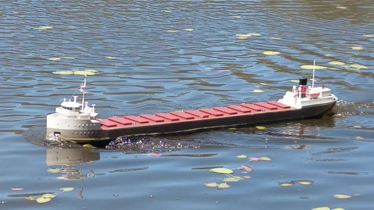

Took the boat to our club today for her maiden Voyage & sea trials.
She needed the full 8kg of lead plus another 1kg block to trim her down to the waterline.
The 40mm prop was way too big so I swapped it out for a 35mm 4 blade prop.
So here's a funny thing.
You will recall that most of the hull is made from polystyrene sheet. As is the main removable deck.
Well, the hull is in the cool water, but the deck is in the blaring sun. The laws of thermodynamics being what they are, allowet the deck to expand in length by over 1/8", causing it to bow up in the middle.
I had to cut 1/8" off the length of it so it would remain flat when it expands.
Unfortunately it seems the bowthruster has sucked up some weed & clogged the impeller, so I will have to pull the pump apart to clear it out.
Apart from those minor setbacks, today's outing was a grand success.

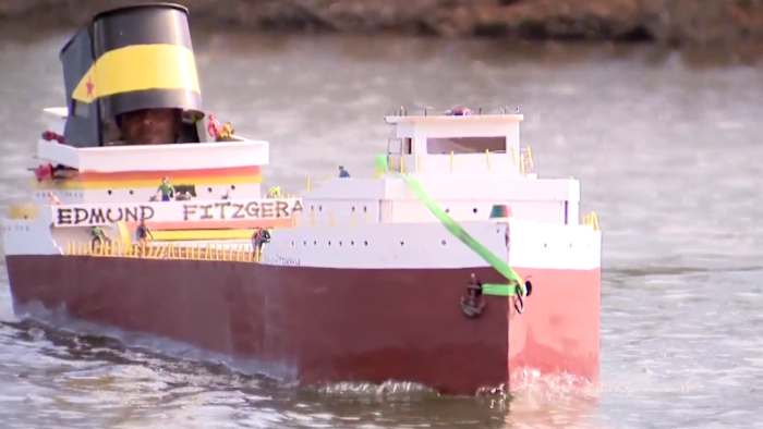

Here are a few pics & a video. Thanks Trev.

How do you haul that ship around? Truck bed? car trunk? or strap to the roof rack?
Yes i had purchased HO scale for my USS Blue Fish, not too many to be had but have quite a sailor crew, shore crew and a Admiral & Captain.
I have a good old Ford Falcon station wagon for my boats.
She fits in the back quite easily, with the back seat folded down. I usually take 3 or 4 boats to the club for a days sailing.See the danger. THEN DO IT ANYWAY!!!
