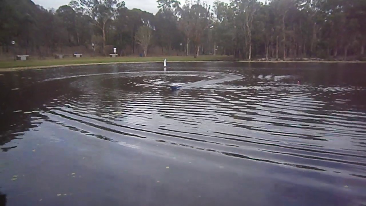

                      Just got back home from her sea trials.
                      Total success.
                      I initially ran it on 4s lipo but it was way too fast at full throttle. About fast scale cruising speed only took 1/5 of the throttle travel.
                      I ran the boat for about half an hour on 4s varying from full throttle to cruising to slow maneuvering, finishing with two laps at full throttle to get a gauge on the heat.
                      Both the motors & the ESC's were barely warm to the touch. No watercooling on anything, so I'm happy with that. Unfortunately the ameter I took to the lake wouldn't work, so no amp reading. I've got another one somewhere so I'll try that one tomorrow.
                      Both packs still had 68% & 64% capacity left in them.
                      So I changed down to 3s packs which is what is in the video.
                      Full throttle is still too fast but cruising speed is now about half throttle travel. Much more user friendly.
                      Still no temperature to speak of in the motors or ESC's.
                      Again, cruised around with slow speed & full speed for around half an hour
                      Packs were at 72% & 74% remaining.
                      The only disappointment is the whine of the motors. Never heard motors like that before. But I can live with it.
                      Here's a few pics from the lake, & a short video
                      The first little part is what I think is scale cruising speed, with a full throttle pass, out the back, at the end.
