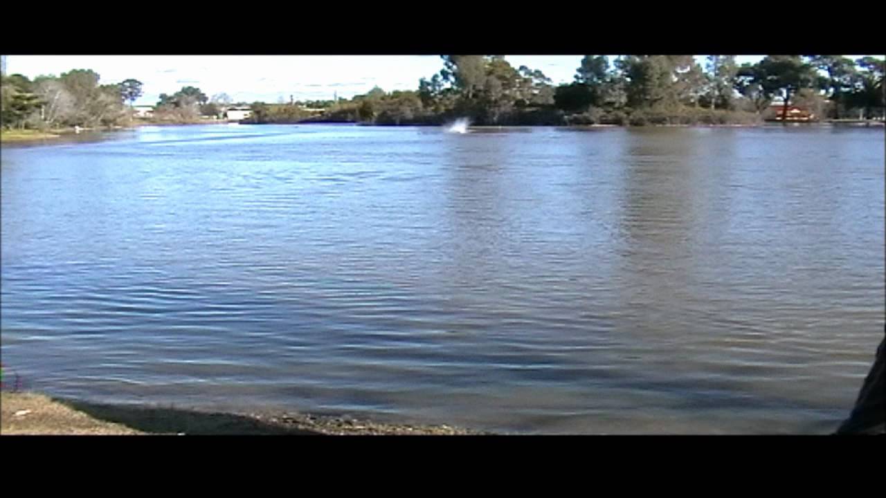

          this is of the x450 on 6s, the first run is with the cog at around 30-31% and the last couple are at around 29-30%cog

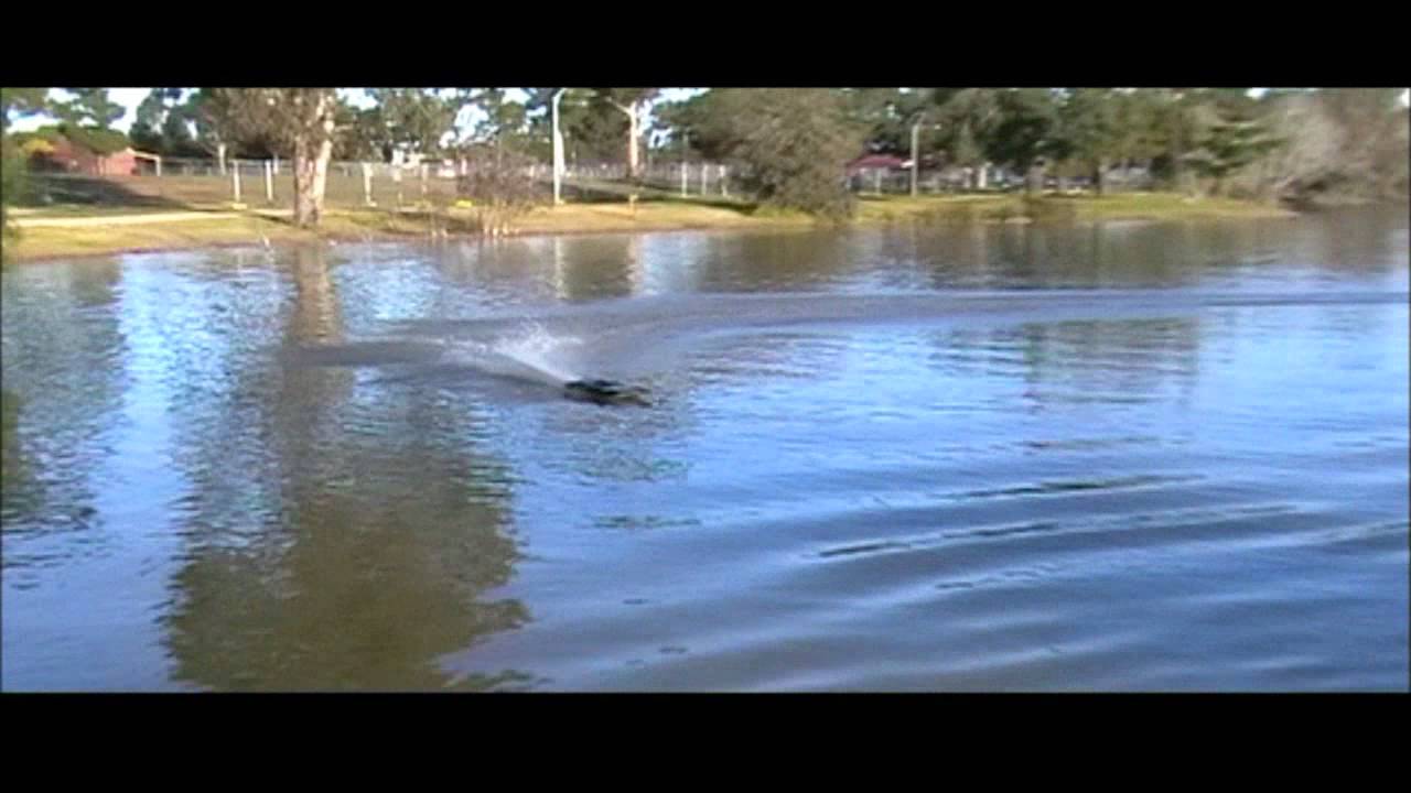

            The hopping is stealing a lot of your speed. Get rid of it and you'll see higher top end. Another problem is the short time at full throttle, it can take the boat a couple of seconds to reach top speed, but you seldom gave it full throttle long enough.
            The hopping can be tough to diagnose, the video does not show the boat in profile much at all so it is hard to see. One thing to try is to raise the strut 2mm at a time until either the prop blows out, or the hop goes away. I never ran a prop that large on mine (45mm max), you have much more blade area so raising the prop may fix the hop. You'll get it right.

              Here's a video trying a x548 and a m447, after putting this video together, I'm wishing I'd tried the x548 longer, I'm now thinking that once I sort this bounce out, it may be a good prop for this set up.
